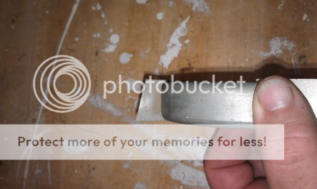

    I came up with the thought.of dovetailing the shelves into the sides. I am ordering a 14 degree cutter from molding knives.com to fit my delta molding head so i can cut the dovetails on the ts. Then ill dadoe out the sides and run a 14 degree dovetail bit down each side to make the pocket to receive the shelf.
    Any thoughts? My.thinking is i may have to make the shoulder cut on the ts first then come in with the moldong head cutter to avoid tearout. Anyone ever tried this?

    Thanks Charlie, I know what you mean about the plywood. I usually use a dado set in the table saw and that was my intent for the shelves. Cut out the dados first then with a jig and template guide run the dovetail bit down the the dado to give me the female joint. (I ordered a 3/4" dovetail bit to keep it simple) and I was planning on just the males on the ts with the molding head. I found that moldingknives.com will make the custom profiles for the delta and corob cutterheads. This way I can run the shelves in the horizontal position and use my sliding table to keep them perpendicular to the fence. With the amount I have to run and all solid stock, I know I would mess up a few of them trying to run them vertically and my shop has low ceilings so I would still have to run several of them on the flat anyway.

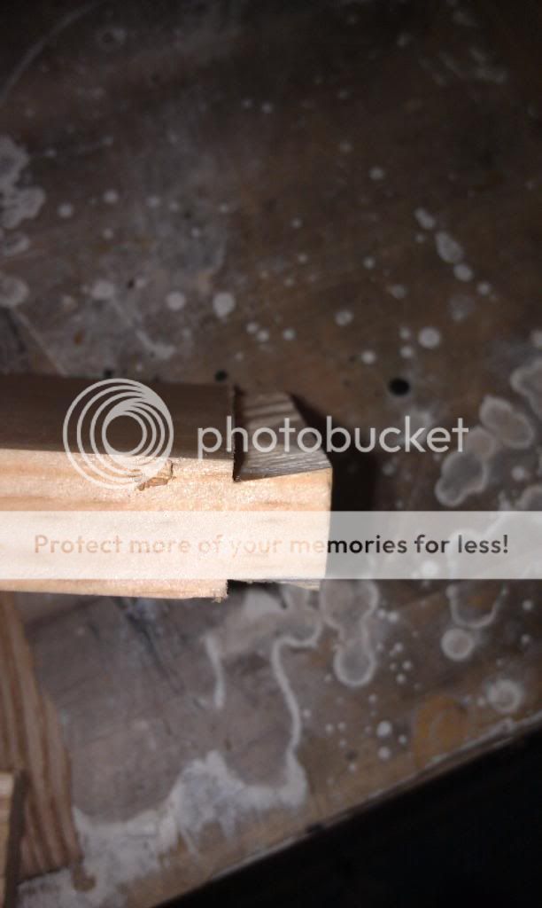

    Just set up the cutters in my molding head and the bit in the router to make a test piece and i have to say it worked really slick! Minimal fuss and the two pieces slipped right together with just the right snuggness. Would recommend it to anyone making sliding dovetails.

    Wunderbar! I am having trouble picturing how a moulding hewad can cut that sort of profile. Treat us to a couple pics if you get the chance
