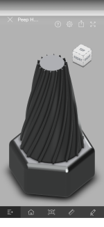

Have quite gotten this fired up yet, hoping to finish installing the lid tomorrow. I also have been needing to drill out and shape a peep hole in one of the bricks that was replaced. I drew up a tool in Fusion 360 to the shape of the Skutt peep hole plug that I bought.
I printed it from PETG to add a little strength, the brick is pretty soft, so hopefully it will do the job. This it next to the Skutt plug.

The reamer worked like a charm. I first drilled a couple of smaller pilot holes with drill bits, then used a step bit to get started with the reamer. I worked it a little at a time until the plug was seated well.
