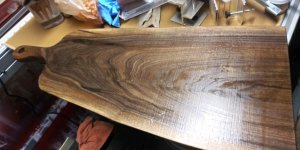

They are great projects for the slabs that the sawmill guys had on the junk pile. Beautiful wood grain and fun to make. I only paid $30 for that slab. I think I can make 2 more out of it.

I assume for pizza? When I saw the slab I immediately thought of the reverse of a river table top, where the board is the river and the epoxy is the outside edge. Man I miss not having a friend with a sawmill anymore.

I like the way you laid those out on the board, the wide sweep looks really nice, adds a lot of texture to it.
Your hanging holes are super smooth/nice looking!! Do you have any tricks you're using for that or just a good drill bit & careful sanding?
When I was making a lot I offset the handle so I could get two boards worth of handles from the same space, for one offs I don't think that it's as useful of a design but when making them in lots of 20+ it helped material utilization some, and for smaller ones I think it looks ok. I roughed these on the bandsaw and then pattern routed the curves & handles.

The offset handles look nice. What ate the dimensions
Around 8-10" across depending on the section of board and around 14-16" long (I went a smidge longer on the thinner ones) plus the handle.

Thank you. They look bigger. I assume you sell them. He will send me pictures, or bring the slabs for me to take a look at. The boards like I made are about all that kind of slab is good for. I have about 3 feet of that slab left from the bigger end. I'm thinking about what to make from that, end table or coffee table or a serving/decorative tray for my dining room table. The first one in the pictures is 24" by 12" the second one is 22" by 12".
