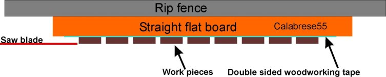

I often need to cut or recut several small pieces way too small to hand hold and pass through the table saw. To accomplish this safely and cut several at once I take a length of straight flat board lay down a strip or two of double sided tape as needed and stick as many of the small pieces as possible to the straight board. I leave a couple of inches on the lead end and a couple of inches on the trailing end to make the entry and exit safer. I use this double sided tape it holds like super glue, this stuff www.amazon.com/dp/B07BBL4JXJ?ref=ppx_yo2ov_dt_b_fed_asin_title
To get a release you can simply try to twist twist the pieces to shear the tape grip but if the pieces are small or delicate use some denatured alcohol on the tape it will release nice with just a little twist or prying up with a thin edge. Best to replace the tape for each run. The picture shows the setup
