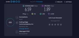

Where we were all week the speed was limited to 5 Mbps up/down, while slower than I was used to, certainly could still get done what I needed to for work. Was even able to connect to my home network remotely to keep an eye on things.
Actually, the almost 7Mbps down does not impact our needs. We have about 4 echo devices, 5 Blink cameras, 2 cell phones, 2 laptops, a printer and 1 Davis Pro weather station all on our network and everything functions. We are accustomed to the loading speed of pages and aren't really upset with life on such a slow connection. Basically by now (over 5 years) we don't really know what the difference would be like to again have a speedy connection. I guess the connection we have matches the pace of our life now.
