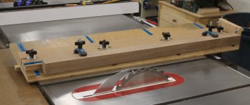

I need to taper these leg blanks.
I cross cut them to final length.
I don't know why I built this taper sled so heavy. I must've thought I was going to be batching out parts for a ship builder or something.
At any rate, the blank gets marked out and laid in place.
The taper is cut.
And it ends up like so right off the machine.
A little hand plane work and it is ready for some joinery.
Three more to go . . .
