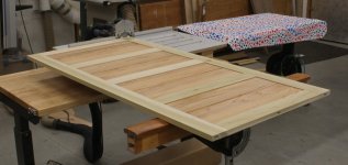

I am starting to have the feeling that using recycled material for this back panel was more trouble than it was worth. I comfort myself by remembering that at least the material didn't go into the land fill. Parts, parts, and more parts.
I start to glue the stiles to the rails for the rear frame.
Now that's ready.

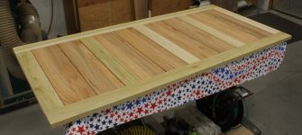

OK, lets get some panels ready. I shellac them on all sides to control moisture over the seasons.
This looks a little confusing so I will blah, blah about it a bit . . . I use blobs of silicone instead of space balls. I use spacers to set the panels in place.
The tape is to prevent things from shifting while I glue the remaining top rail in place.
Now I go do something else until tomorrow. The one downside of silicone instead of space balls is that it has to set for several hours but, after 20 years of success it is hard to change. I have plenty of other stuff to do in the mean time.

The frame and panel back didn't come out too bad. remembering that it is made up of reclaimed material . . .
