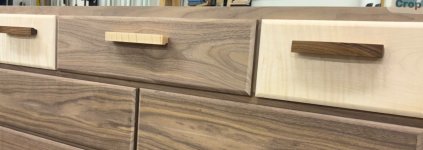

Guest Bedroom Dresser
Finally. I never thought I would get those drawer boxes in.

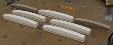

Time for some pulls. I want these to have a reasonable amount of face surface so that they show off the tiger maple.
The tiger maple drawer fronts will have walnut pulls and I find an odd-ball piece of scrap in the bin that will yield the two pulls I need.
I end up with these five maple pull and two walnut pull blanks.
I drill the holes for the inserts.
Its a process . . .
I seem to have missed the router table cove process but it is pretty obvious.
I swear I have been using the same "toilet ring" of wax for a decade to lube screws and such. I put a dab of it in the holes to make the inserts drive in easier. The hole is drilled to the diameter of the insert shaft to prevent splitting.
I do this at the drill press to make sure things go in perpendicular and true.
I use an insert tool from . . . Oh, here it is . . . E-Z-LOK.
I open the top of the DP and turn the drive sheave by hand to drive in the inserts. This take a little more time but I find well placed inserts to beat misaligned inserts every time ;-)
And there we go so I have to go oven bake some thick-cut bacon now in anticipation of dinner tonight.

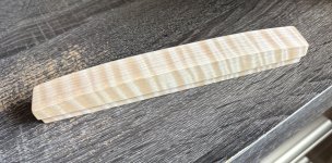

Here's a first run of what I think of as shellac flooding. For light colored figured woods this lets the shellc dive deep into the softer material and emphasize the figure.
These will be top coated with a lacquer later on in the process for protective reasons but, I really like the look of the shellac on the tiger maple. Speaking of liking the look . . . as mentioned I didn't document the side tables very well because I thought they were a "one-and-done" sort of build. Life says "Nay-Nay". I do a test board to figure out what mad scientist formula I used with the side tables.
LOML says "they all look the same" until I hold the test board up against the side tables. Then she says "Ah-ha" . . . ;-)
I have received her blessing on the pulls so away we go . . . the iPhone auto-adjust coloration makes this look a bit odd but, you get the drift.
