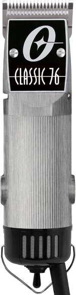

I stopped in a while back a the local barbershop to have my ears lowered. While there I noticed the owner fussing with the vacuum hose attachment on his hair clippers. He mentioned it was breaking and he said he couldn't hardly find the attachments anymore. I offered to try and make him a 3d printed version, and he was interested. I stopped in this week to see if he found an old one I could use to model one off of. He hadn't been able to find one, but his son mentioned they had a bunch of the old clippers in the parts grave yard and asked if I could use one of them to model from, which I thought I'd be able to. He grabbed one for me and I took a few pics of one of the attachments.
These are on an Oster 76, like this one.
