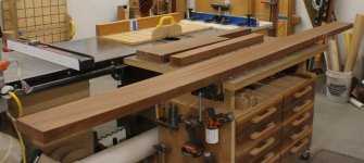

I rip my selected top-of-frame and hanger-bar parts at the bandsaw.
The adjustable tables come into play again. My jointer tables are long for a little 8" but, not long enough to keep these 65" blanks in plane.
The bow in these blank is obvious. Fortunately I have plenty of thickness to get what I am after.
Once a face and an edge are milled true I can rip to width.
A couple of runs through the planer and we're all happy.
Time for some coffee.
