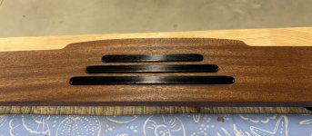

These are not glued down. Simply setting in place but I like the look. I find hand preparing these types of things lends a more organic look and feel. There are other times when I prefer a machine to provide a consistent purposeful look. It all depends on what you are doing and what the look is that you are after.

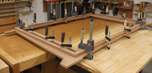

Resolved the sizing issue and used Dominoes for the corners of the long, thin, sub-frame rails and stiles. This large frame is proving to be a space challenge as I have other things going on in the shop right now. Doing a staged glue up actually works out for me today as I have a lot of clean up work to do in the back yard. I can glue and clamp a sub-assembly, go work in the yard, come back and take the next step and go back out in the yard. The joys of retirement and building for yourself; no schedule.
I developed the habit long ago of gluing up frames in a pair of "L's". This is an extra step from just gluing up the whole frame at once but I find I get better results this way. This lets me assure the corners are square and that the surfaces are in plane. I use the same method on picture frames, boxes, almost any square or rectangular assembly. We all find our own ways that lead to success. I set a timer for about 30 minutes and then will connect the two "L's" and move along.
