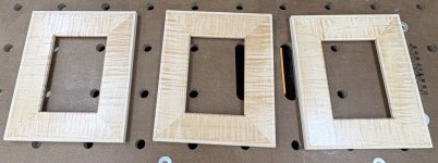

Picture frame turn buttons are inexpensive and very useful for making frames. I have a small bottle of turns and screws that I keep in my "project supplies" tackle box.

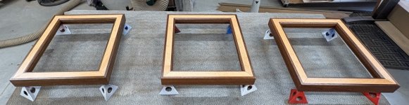

Final top coat . . . finally.

Same for the outer frame parts.
