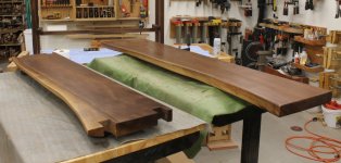

Before I do the final finish work I want to drill the holes for the figure 8 connectors. The bar gauges come into play again to assure that I am square.
I use old gift cards to assure a bit of clearance for seasonal movement on these captured areas.
I did need to put just a touch of diagonal pressure on the open faced framework.
I was going to mark the holes, disassemble and drill but decided to go with an extended Vix bit and drill the holes in place. The tape is to protect the material from rub marks should I wander.
It will come apart again for the final finishing stages but I do get to get a look at what the table is going to look like.
There are always more things left to do before the finish line than you think. Posting more baby steps here but things get sooo slowww towards the end. Here I am aligning the figure 8 connectors for the top with the shelf affixed in place. I do these sort of steps right before I finish the finish and do any other detail work. That way I can fix anything I goof up during the final steps.
I use painter's pyramids, deodorant toppers, and hockey pucks for assembly / finishing support. I have also found 45 degree off cuts from mitered panels to be useful for narrow or awkward pieces.
I keep a bunch of them in the bottom of one of the rolling tables.
Ta-da.
I am a dumpster-diver. I scrounged a big roll of these paper squares from a shipping place. Once the roll gets down to the last few dozen they swap it out and recycle them. I asked if I could have a roll-end, they said yes, and I have been using them as throw-away drop cloths for years.
When it comes time to finish the finish, these are my usual suspects for that process. With 1500 or 2500 grit stuff you can buff out shiny spots, disguise weird chatoyance from reversing grain and so forth. The raking light is something you should always have on hand.
Here is the top after buffing out a clear lacquer top coat and adding a paste wax finish..
Same for the shelf.
I know I am really "done" when I land the date medallion.
I promise the next pics will be with it in place . . . :)
