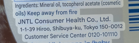

PS, I have been using unscented bay oil for my cutting boards, as the butcher block oil is stupid expensive here, and I cannot find the laxative mineral oil here.
The baby oil is basically mineral oil and tocopherol acetate, which is used to make your skin nicer, not exactly food safe, but you are not supposed to eat the cutting boar LOL.
