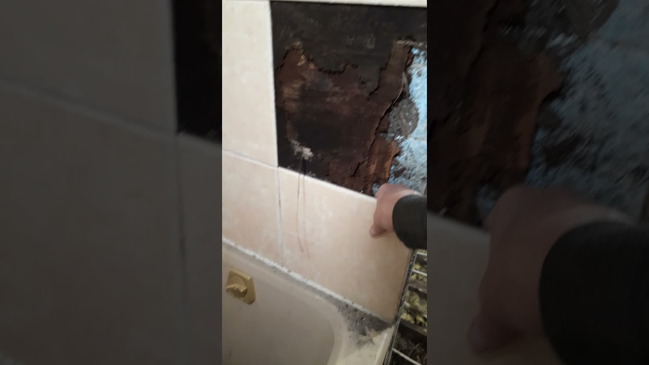

I'm doing a renovation of an apartment, I was supposed to be doing only the floors. I found a LOT of water damage. I have to fix that before I can button up the floors, found the problem in the bathtub room.
Tech tip, don't use plywood to mount bathroom tiles, just simply NOT a good idea.

Demo work us not fun LOL.
This us the vent hose used, smashed almost flat, utterly useless.
Most of the tiles are coming off easily, my cordless hammer drill on the hammer only setting with a chisel tip on it takes care of anything else.
Getting there.
Now to clean up the mess and cut up the bathtub for removal.
