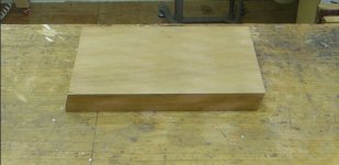

I made this stool to climb on it to reach high things and to sit on it when working at ground level to avoid crouching for long times, the wood I used is Samanguila, Khaya ivoriensis.
After drawing it and deciding the measurements, I started by cutting the feet, first I cut the top and bottom edge at the required 75º angle.
Then I drew the the tenons and the lines to cut the sides in order to get a trapezoidal shape.
I cut through those lines on the bandsaw and used the angled edge of one leg as a guide to pare away to the same 75º angle where they will join the seat

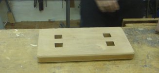

Then I drew the holes on the seat, on both sides of it as the holes need to have also that same 75º angle.
Then I inserted an hexagonal rod on my colum drill and I set the base at the 75º angle required to make the holes for the tenons.
Continuation:
I drilled holes near the corners to use them as a guide when chiselling away the wood to make the square holes for the tenons.
I used the angled edge of the legs as a guide again to pare away the sides of the holes at the right angle.
Once the holes were finished I rounded the corners and chamfered the edges with my router.
