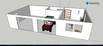

I’m still planning out the layout. We’re undecided if we take some additional space from the second bay to build a separate kiln and drying room, or make the first bay work, with the kiln on a rolling cart and shelving. I’m planning to install concrete board on the walls and ceiling around the kiln. I updated the electrical service a few years ago, so we should be ok as far as that goes. Floors will be left as the current concrete for now, though it may need some self leveling mix added over it.
We’re also undecided if we’ll access the rest of the garage through her space or just move the current door over on the end closest to my shop, which I’m leaning towards, we can always open a doorway later if need be.
Currently, We’re looking at about $3,200 to finish out the space, adding the wall, adding windows, new door, insulation, sink, and a mini split. If she decides to add flooring, we’ll be looking at another $400 or so
Current foot print will give her about 12’ 6” x 21’ 3”, 8’ ceilings
Thanks Dave! Yeah, I started a sketch-up of the space and want to print some scaled cut-outs of things like the kiln, pottery wheel, wedging table, work table(s), sink, and shelving. That way she can try to organize the space a bit before we commit to things. I'll add some tool carts to the list. I still need to figure out how to do some things in the on-line version I used to be able to do easily in the installed version.
I'd hate to lose the rear portion of the 2nd bay for a separate kiln and drying room, but I think 1) having the heat from the kiln somewhat contained in a vented room would make the studio space more enjoyable to use and not make the HVAC go nuts. 2) Not having to move the kiln and things stored around it to use it would be safer for her. I can completely wall up the room with concrete board for heat and fire resistance. 3) Happy wife, happy life. ;)
