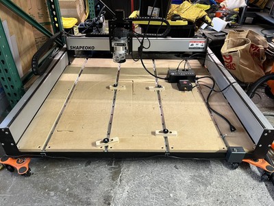

Lots of people like the X-carve, or the Shark from Rockler. You can get a Chinese import or a kit on EBAY.
Rigidity in the machine is very important as well as the power of the drive motors - steppers
USED - take your chances - why are they selling it??
I don't know the quality
This is very similar to what Toni C has
There are just so many choices out there it becomes a difficult decision as to what to select.
