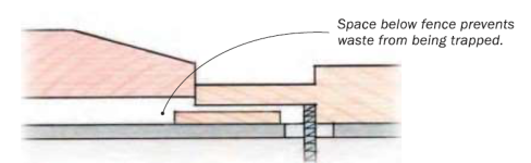

Well, my L fence, although not quite as fancy as the one posted, works well with my Unisaw and Unifence, but it doesn't have the fancy tapered edge, nor does it have the dovetail clamp slots. I've been using the sacrificial fence clamps from Rockler. They have worked OK, but I really like the idea of going with the dovetail clamps. So maybe it's time to rebuild and improve my L fence. I already have several pairs of dovetail clamps, I just haven't upgraded everything to make full use of them yet.
Thanks for the post and design idea,
