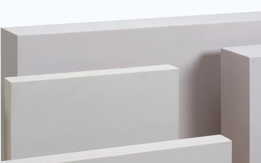

I do not make outdoor signs out of wood .
I use HDU - High Density Urethane.
It does not
Shrink
Swell
Expand
Contract
Rot
Split
It DOES
Impervious to weather
Stable
Paints well
Light weight
extremely easy to work with
Like cutting air on the CNC machine
I use Benjamin Moore Aura exterior paint
I set up a business account at a local sign store that sells ONLY to businesses
Brands
Signfoam
Precision Board
Oh lots of others that I cannot remember
Oh I dunno - there are more reasons I do it this way but I cannot think of them at this moment

As suggested, Corian is excellent and usually very reasonable. Cut-outs sometimes free. But, if you want wood, I suggest basswood as the most workable. There is a major supplier in Wisconsin. A Google search might find him. If not, I'll ask a friend in our local wood carving club for his name, he comes to the local wood carving show here once a year. I have bought some of his wood and it is beautiful. Clear, almost pure white, and carves beautifully without tear-outs.
Precision Board is what Dan Sawatsky uses. He uses 30 # exclusively. He makes millions of dollars and he can afford it. It is really hard as HDU goes - still really easy to work with. The 15 pound Precision Board, in my opinion is more then adequate.
I use 18# and 15# Signfoam. Different brand but still good stuff.
