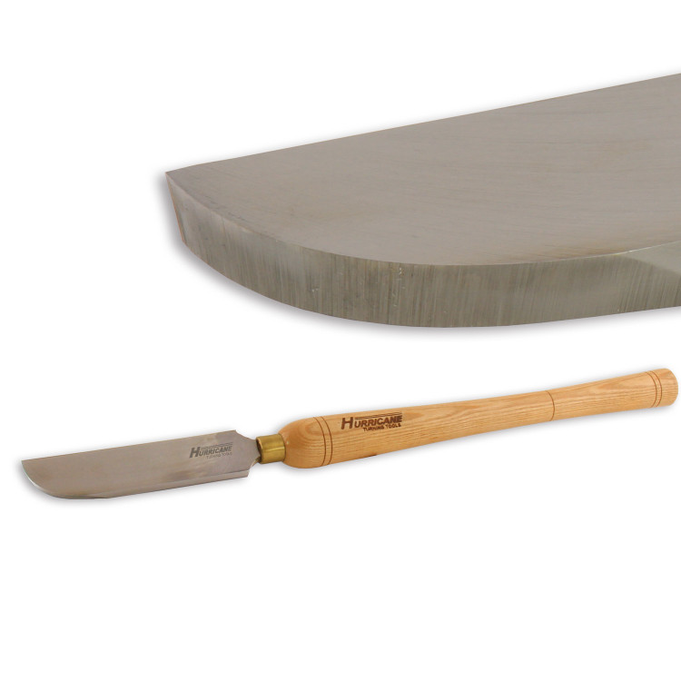

You'll note that the scraper Vaughn suggested is curved. There's a temptation to use a flat scraper to make a flat inside surface. While that can be done it often ends up like your situation. The problem is that the corners will almost always find a place to catch and dig in unless you use it just very precisely so with exactly the right tool angle. The curved end scraper is much more forgiving (not that it's impossible to mess that up, I've certainly found a number of ways hah). Note I'm not saying it can't be done, just that it requires and abundance of skill and technique which most of us lack, and all of us lack initially.
