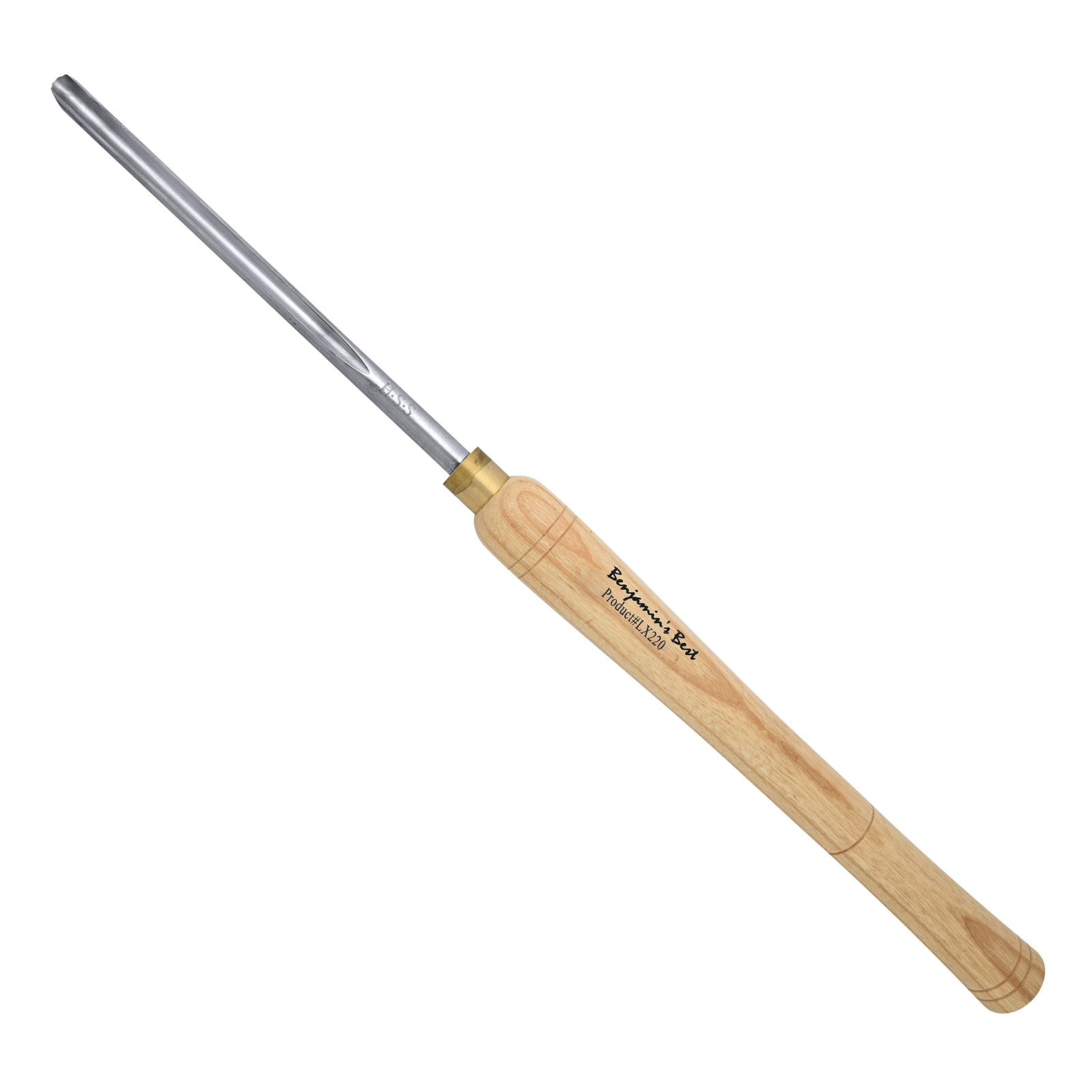

Bowl gouges range in price from about $25 to over $100. In general, the more they cost the better the steel and the longer they hold their edge between sharpening. Before I started buying really good gouges (Thompson Lathe Tools, $70 to $120 each without handles), I got a lot of miles out of a bowl gouge like this from Penn State:
As you shop around for bowl gouges, you'll see the fluted part comes in different shapes (generally U or V shapes) and there's a wide range of tip shapes. If you poke around the Thompson Lathe Tools website, you can see some good examples of the different flute and tip shapes. I prefer a tip shape with the wings (sides) of the tip swept back quite a bit. Other folks prefer a more squared-off tip. The tip shape is something you can change yourself buy how you sharpen it on the grinder. The flute, on the other hand, is not changeable. I have both U shaped and V shaped gouges, and like the both.
