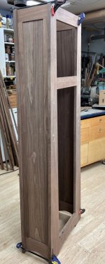

Yesterday I finished the 'skeleton' and test fitted all the joinery. Today I'll work on gluing up all the panels.
I was very fortunate to have gotten my lumber from Larry for this project as he was very thoughtful in choosing boards from the same flitch. I was able to capitalize on this using two contiguous boards for the front legs. A little hard to see right now, but once the oil goes on they will appear to be book matched. Win win.

Nice job on the crown profile stack (y). The overall pictures give a good look at the scale of this beauty . . . whew! Nice choices on the side panel figure. Purposeful material selection is one of my favorite parts of the process and things are really coming together on this one.
