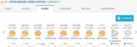

We are finally starting to heat up a bit. First time in the 80's this year. Here is our current 10 day forecast. Notice the nightly lows.
